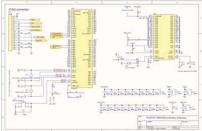

Please refer to the AN4661 "Getting started with STM32F7 Series MCU hardware development" especially the figure 24:

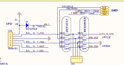

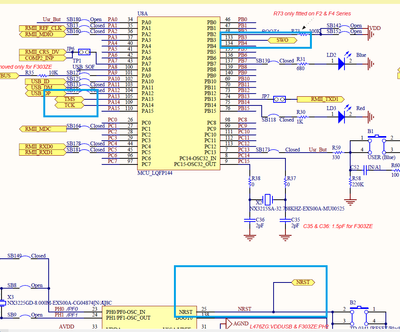

For ST-Link connections, you can inspire from NUCLEO-F767ZI board schematics:
Hope that helps.
