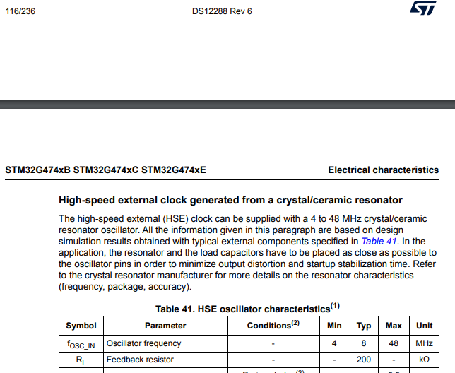

Hello @sag
This MCU minimum HSE resonator Frequency is 4MHz. You can't use any other value under 4MHz.
For the Current consumption of your MCU, you may can refer to the Table 35 of the DS12288.

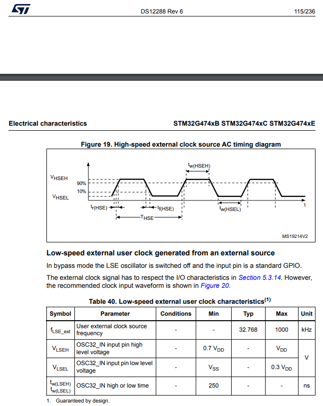

If you want a lower-speed external clock, there's LSE:

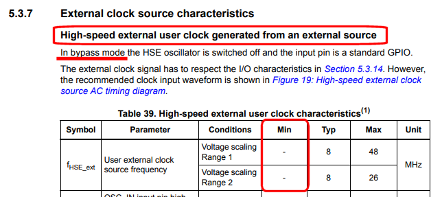

@STTwo-32 wrote:This MCU minimum HSE Frequency is 4 MHz. You can't use any other value under 4MHz.
But, when operating with an external clock source (so not using the HSE oscillator), there is no minimum limit stated:

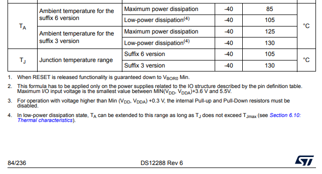

2024-10-21 1:33 AM
Our operating temperature is 180 deg C which will cause drift in internal oscillator at higher temperature.
The stability is not good at higher temperature.
2024-10-21 1:37 AM
@sag wrote:Our operating temperature is 180 deg C .
That's well outside the specified operating limits:
2024-10-23 3:02 AM - edited 2024-10-23 3:03 AM
So can i connect 1 MHz then if lower is not mentioned at clock generated from an external source.
Same for 2 MHz external clock
2024-10-23 3:32 AM
@sag wrote:So can i connect 1 MHz then if lower is not mentioned at clock generated from an external source.
So it seems.
To be clear, that requires an external, active source - not just a crystal.

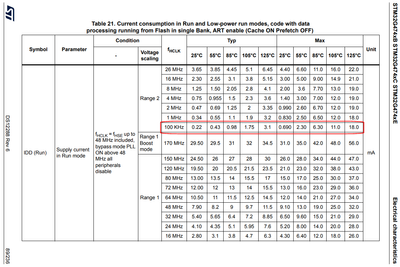

eg, here you can see that even at 100kHz, you'll typically draw 0.22mA:
whereas in the sleep modes that can be a few uA or even nA ...
In other words, sleep modes are more beneficial than running with a slow clock.
