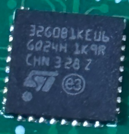

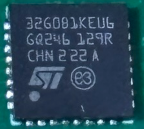

I am facing this issue in 25% of mcu boards.
Bootloader version - 0x12(For I2C protocol V1.2)
I have another batch mcu where the mcu is not entering the bootloader mode even after making boot pin high. I have attached its image and description below,
