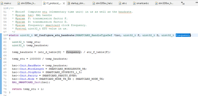

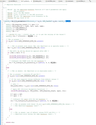

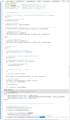

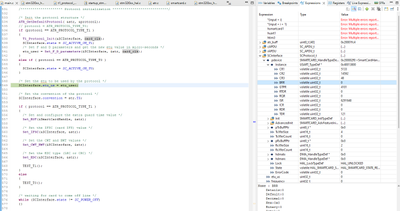

I am not sure about this code in AN4800 FW.
in main()
uint32_t cardclk = 0;
Passed to Set_F_D_parameters() as parameter SC_clk, where on line 96 it is used as division by zero
Then passed to SC_Configure_etu_baudrate() as parameter frequency, where on line 63 is used as division by zero, and the same on line 65.
Which results in BRR baudrate to 0
I do not think the T=1 can correctly work with firmware.
What should be the value of card_clk on STM32L0538-Discovery?
