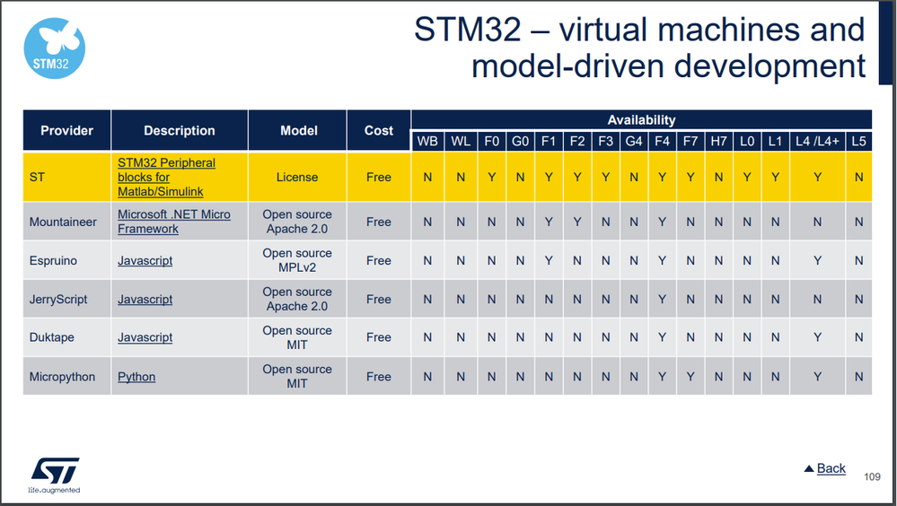

Hello Skund.1, unfortunately,
ST does not support officially the STM32F2 with µPython.
ST support only STM32WB55 with Micropython for the moment.
Please have a look to the Micropython community https://micropython.org/download/stm32/, maybe they plan to support the STM32F2?
If you need to use Micropython on our product, we will pleased to support you on STM32WB

In our application we want to use Micropython in Virtual Machine.
In "STM32 and STM8 embedded software solutions" document I found this
Based on the above picture we should be able to use it on F4, F7 and L4/L4+ series.
What's the reason for not supporting on STM32F2 series, is it to do with memory issue or something else?
Regards
