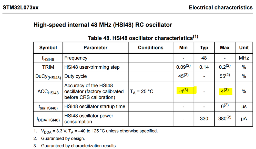

The accuracy of the HSI48 is listed in the datasheet.
https://www.st.com/resource/en/datasheet/stm32l073v8.pdf
I doubt that ±4% accuracy is sufficient.
