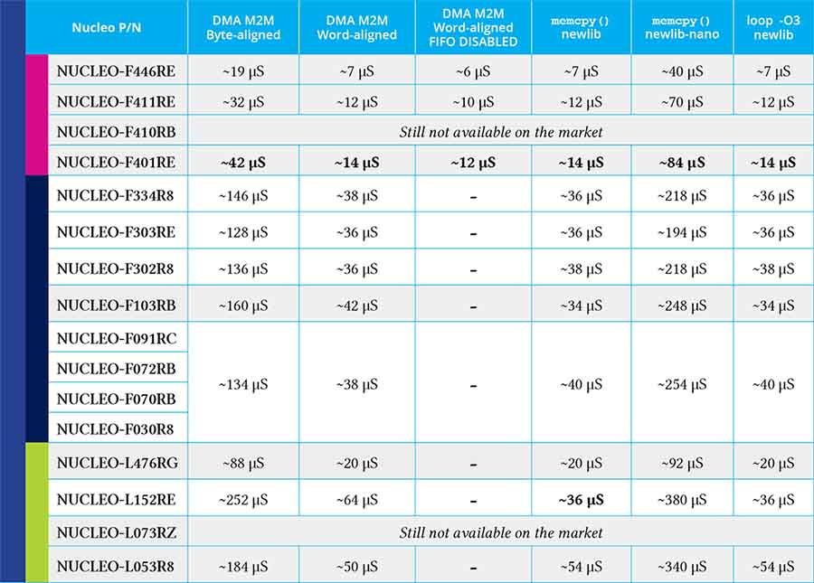

Your results depend on several factors. What compiler are you using? And what about the libc release?
For example, the newlib library provides a speed optimized version of memcpy(), which automatically detects word-aligned memory transfers. The newlib-nano memcpy(), being optimized for size, it doesn't perform this type of check. Moreover, you should also try DMA m2m transfers word-aligned: for some STM32 MCU you can achieve more than 4x speed-up.These are some test results I've obtained on a wide range of STM32 microcontrollers:2016-02-10 4:13 PM
2016-02-10 10:11 PM
There is just one other thing to take in account: linking the newlib, which provides the performance optimized version of memcpy(), costs about 10K of additional FLASH memory. For smaller STM32 MCUs (e.g. low-cost F0 with less than 32k of FLASH) doing it with DMA is preferable. Moreover, the DMA setup cost is not unimportant as stated by clive, so a DMA M2M transfer makes sense only if you have at least 30-50 elements to copy.
