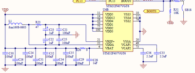

Hi TDK
I have uploaded circuit diagram how I am using VREF external selection which giving me 2.95v on multimeter.
so my above issue are same.
