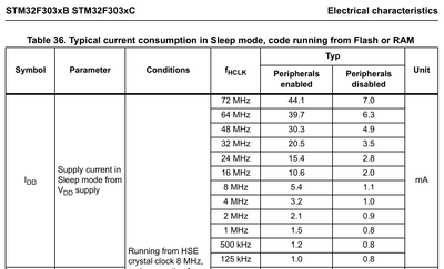

> I estimate from official data that it will be 60mA.
Seems a bit high. Could be right. The datasheet has detailed info on current consumption. This is just one of many tables:

Do you think the STM32F373 series can be even higher if estimated this way? I plan to use a 200mA LDO to power it, but I don't know if it can support it.
2025-06-04 5:58 AM
I would estimate that 200mA is plenty for the MCU and your peripherals, at ambient. Probably will take closer to 50mA or less.
