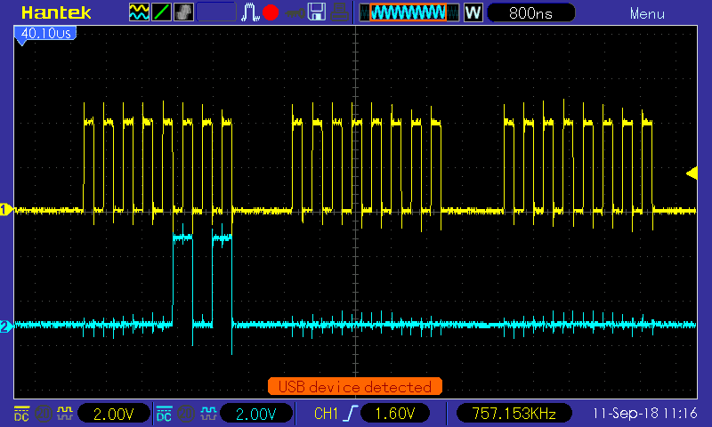

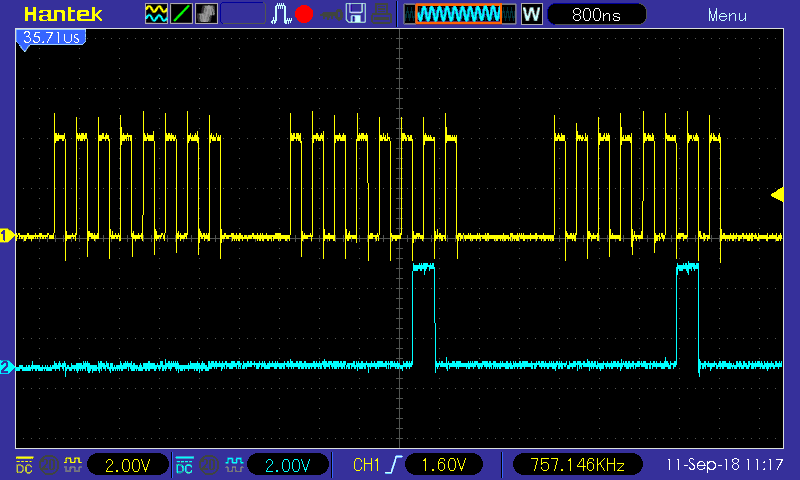

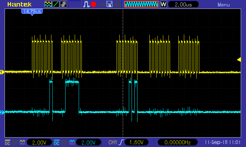

You'll basically have to scope the pin, or use logic/protocol analyzer, and confirm the patterns seen on the pin to those reported by the STM32. You might have to review polarity/phase of clock.

}MOSI Signal Can work.
But MISO Signal Can't work.
