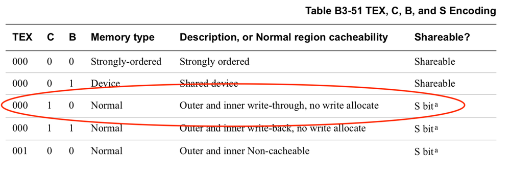

Correct, but the register you mentioned in the ARM documentation is indicated to be optional. In another ARM document ''System Memory Model'' ARM indicates this: (this is at the level of the MPU).
S is for sharable or not!

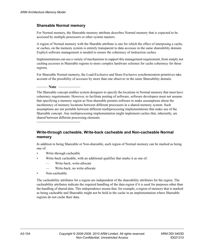

At that level, there's no explicit connection between shareability and cacheability yet, just a set of requirements for the implementation - see screenshot below. The details of what shareability implies (with regard to exclusive instructions for example) is described in that ARM: the details of cacheability are not dealt with at all, so it may simply be a signal output from the processor, left to some of the implementations levels what to do with it.
