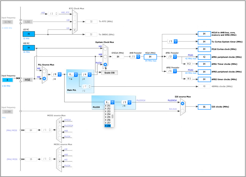

N is a multiplier, R is a divisor. its slowing down the i2s clock when the audio frequency is lower. plug your values into the STM32CubeMX application's Clock Configuration pane and you can see the changes to the i2s clock frequency.

So the general rule is lower is sampling frequency, slower should be the master clock. Are there amy other constraints? Looking at
STA350BW's datasheet some internal clock's frequencies are fixed in reference to sampling frequencies. Is there a link with master clock?
PS in 44800 Hz case, clock seems slower than 44100 Hz case.
