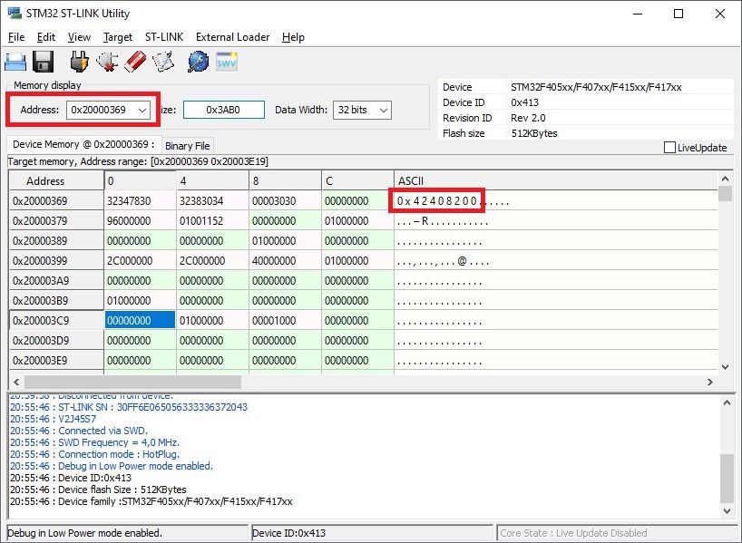

2025-05-20 12:17 PM
@DiBosco When I sometimes want to look to value I use my small function which convert data from R1 register to ASCII HEX string to buffer pointed in R0 register.
Declaration in C looks:
extern void my_htoa32(char * buf, uint32_t data);
But if you want invoke this from assembler you should to do:
ldr r0, = 0x20000369 // for example a free area for use as buffer 11 bytes
ldr r1, = 0x42408200 // value for tested
BL my_htoa32
lll:
b lll // neverending loop
Function my_htoa32:
.syntax unified
.cpu cortex-m0
.fpu softvfp
.thumb
.thumb_func
.global my_htoa32
.type my_htoa32, %function
.text
// HEX 32BIT value convert to string
// INPUT:
// R0, = ; POINTER TO OUTPUT char DATA BUFFER
// R1, = ; VALUE TO HEXADECIMAL CONVERT
// output: no output, data in buffer are output
my_htoa32:
MOV R3, 0x7830 // "0x"
STRH R3, [R0] // STORE "0x" TO BUFFER
MOVS R3, 2 // output data 2 bytes after start buffer
LP01:
LSRS R2, R1, #28 // R2 = OUR DATA TO STRING CONVERT 1 BYTE = NYBBLE 0..F
LSLS R1, R1, #4 // R1 * 16 = R1 << 4
ADDS R2, R2, #0x30 // CONVERT TO NUMBER
CMP R2, #0x3A
BCC LP01A // if data < than 0x3a don't add #7
ADDS R2,R2, 0x07 // CONVER TO LETTER
LP01A:
STRH R2, [R0, R3] // STRH store byte and zero terminated
ADDS R3, R3, #1
CMP R3, #10
BNE LP01
BX LR
The result you can observe in STM32 Link Utility or in Cube Programmer:
