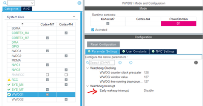

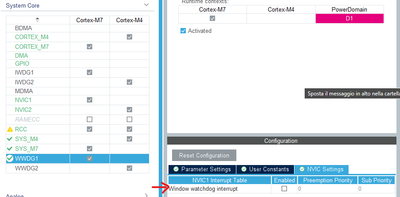

2025-05-06 1:28 AM
@Pavel A. and @AScha.3 , thanks for yours reply.
Regarding the two interrupt:
this one is the "normal" one, which is also reported in the NVIC1 section.
this is the EWI.

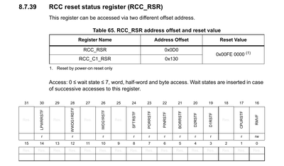

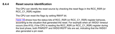

2025-05-06 9:39 AM
>I would like to recognize the reset cause:
For this : see rm, there is a extra register...
