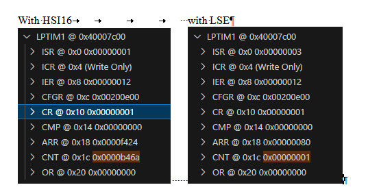

2023-11-15 11:52 PM
Here are the register values left with HSI16 were everything is fine, right side with LSE were it only counts to 1. Both should count to 0.5s. why the ARR value is different. I think it has something to do with the ISR/ICR Flags, I also read about in the errata es0393. But even if i don't use the STM32CubeMX code, I do pretty much the same thing to initialize and start the timer. And the interupt handler is also pretty much the same.
I've also tried different Timer Modes (Counter, Timeout, PWM), the behaviour is always the same.
2023-11-17 7:47 AM
Devil is in the details, here, the particular way how you've set up the timer in code. As you've shown us no code, here's some theory.
LPTIM is a dual-clock module - registers are accessed from the system (including processor) through the APB bus, and that domain is clocked by the APB clock; and the real working counters are clocked by the asynchronous clock, in your case LSE.
ARR (and CMP) registers have in fact two copies, one is in the APB domain (let's denote it ARRapb) and other in the asynchronous domain (let's denote it ARRasync). Readback comes from ARRapb, while the actual counter works with ARRasync.
Values written to ARRapb are copied through a hardware mechanism, which works only if the async clock is present This demonstrates itself also in the fact that RM requires LPTIM_CR.ENABLE to be set before ARR is written.
So, what I think happens in your case is, that you perform such sequence of operations, which write into ARR while the asynchronous clock - in your case from LSE - is not present. Maybe it's not stable yet, or maybe there should be delays introduced in some point in your program.
At any case, after the write, you should check if ARRapb has been copied into ARRasync, by checking LPTIM_ISR.ARROK.
