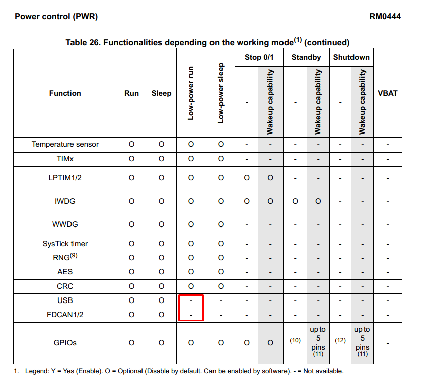

The RM states some peripherals like USB and FDCAN won't work ("not available") in LP-run mode.
I didn't test USB, but FDCAN seems to work in LPR.

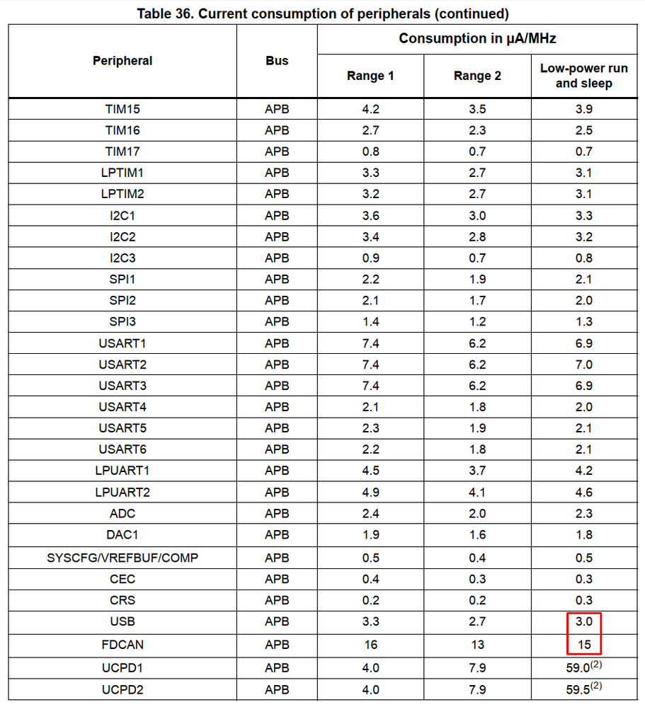

Also the datasheet lists these peripheral's power consumption in LP-run mode, and it's pretty much the same (give or take) as in normal Run mode (so, they appear functioning in this mode at least according to this particular table).
So, am I missing something or it is indeed a discrepancy here (should I expect FDCAN & USB working properly in LPR or not?).

Hi @AYash.1 ,
I can double check with the team, but for me the FDCAN and the USB should work in Low Power Run and Low Power Sleep modes.
Because the Low Power Run has no effect on the clocks and keep them ON.
For instance, you can use the HSI48 as kernel clock for the USB and the HSE as kernel for the FDCAN and it should work.
I escalated this, to check if we should update the reference manual or not.
