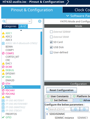

As always: what fits your needs, the cpu dont matter. Most used here is probably fatfs .
Can be selected in Cube:
...also for external flash...
So for your pictures : are pics fix - or changing many times ?
-> just because you write them once to the external flash or want to modify them often?
If fix, i would write them simply as data arrays, no file system needed.
If edit pics, change them often, i would prefer something like a sd-card, with fatfs (so edit on PC is easy).
