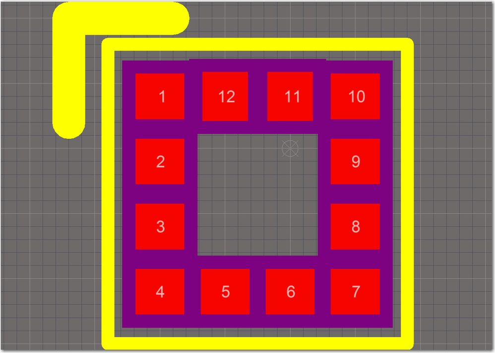

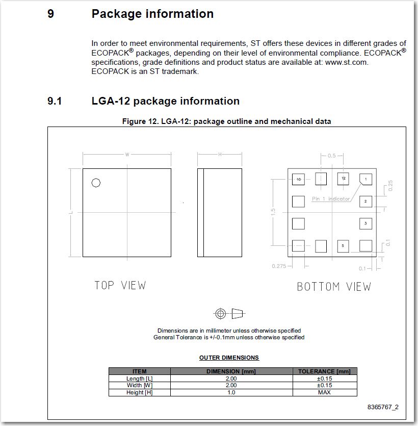

I tried to check the connection on LGA-12 package,
Is it possible that I put extra pad larger horizontally so it's easier to check?
Currently I used the same size as in datasheet
Thanks

Put test pads off on thin stalks, so you don't have to put solder down everywhere

any photo example ? I don't understand by "test pads on thin stalks"?
2019-08-04 2:32 AM
This is what I have,
may be extra pad to the left, up, down and right, so I can check with my connectivity tester ?
