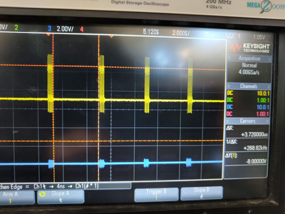

i am performing some 400bytes blocks transferts by SPI, at 16Mhz.
I have NSS off, so no CS up/down between frames.
From some testing, whatever system clock i set, or whatever spi clock i set, there is a fixed 4us time between 2 consecutive frames. This pause is of course very visible and heavy at 20Mhz spi clock, by scope something like:
__||||||||_____________||||||||______________|||||||_____
Transfer is done by LL_SPI_TransmitData8
If any help to reduce this delay between frames, would be very good, or at least to know i cannot reduce it in any way will be helpful too.

Well, code is actually the one in zephyr os, but anyway, i changed mcu clock speed
from 80 to 120Mhz, this delay is still exactly the same, 4us. So looks like the code is not impacting it.
Sure, if you confirm i cannot move it down, my next step is using DMA.
And, question, could the TI mode help here (i can control CS by software in case) ?

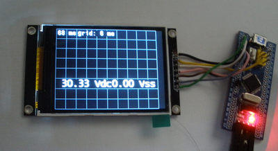

I am using the SPI to drive a 2,2" TFT here :
Writing the line/grid needed 305ms with standard HAL_ calls ,
optimized access with direct register write now needs 6ms !
(always at 18Mbit speed , no DMA, maximum with spi2 on a F303 cpu)

SPI2->DR = cmd; //HAL_SPI_Transmit(&ILI9341_SPI_PORT, &cmd, sizeof(cmd), HAL_MAX_DELAY);
HAL call needs about 900ns , direct write about 14ns . (But no error checking etc , what HAL always doing.)
I use the HAL (hoping: no errors there) because you get , what you want without much fiddling around.
And if something should be faster, i play the game to write direct.
See : most times its not important, when you switch on something, needs 10ns or 10us - you anyway (as a human) many times slower, to see it. Just in some cases, here when drawing the background grid, you really see 300ms drawing the lines; so here is a point, speeding up is useful . Then same drawing in 6ms - you cannot see , it looks like "instant" grid there. But this is just like a crossword puzzle for me - just for fun.

I did a brief test, writing my data blocks by
while (l--) {
*(volatile uint8_t *)(0x4000380c) = *p++;
}so writing on data register excluding any other os code.
Result is always the same
The gap between frames is of course very visible since i use now 20Mhz spi bus clock.
So seems i cannot improve this behavior in any way as of now.
