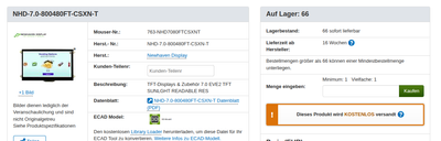

so for a 1024x768 pix display, the first question is : what it should show ?
Maybe hi-speed video or animation for a game - or GUI for process or machine controlling ?
So for a GUI , and using a "small " cpu (compared to the SOCs used in mobile phones) , its good idea, to use a display with onboard graphics and frame buffer , so the cpu just giving graphic commands to the display, connected with a SPI .
I use the TFTs with EVE graphics, the TFT has almost same price range as a plain "***" TFT frame.
Just look at mouser...
btw 1024x768 seems very unusual , more is : 800x480 , 1024x600 or 1280x800 ;

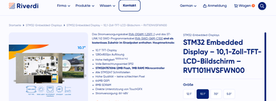

or look at displays, with STM cpu already there...
... many others also, just ask google :)

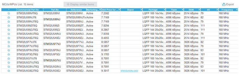

You ask MCU then STM32U5 is only one with internal RAM sized for single buffer RGB565 optimaly, or moremore power new N6...
Display you can choice RGB or better DSI.

2025-08-04 2:42 AM - edited 2025-08-04 2:45 AM
So look yourself...
https://www.st.com/content/st_com/en/stm32-mcu-product-selector.html
with RGB par. -> maybe STM32H7R3Z8 , 144pin lqfp.
2025-08-04 2:48 AM

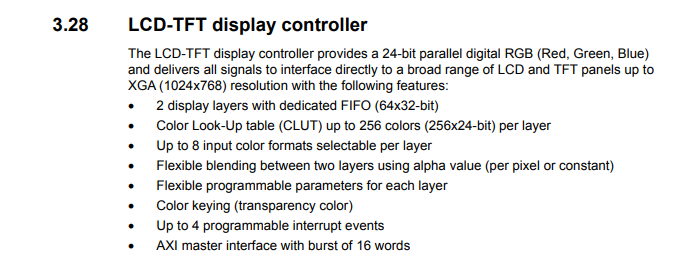

all have RGB ... STM32U5G9J-DK2 - Discovery kit with STM32U5G9ZJ MCU - STMicroelectronics
but check pinouts
2025-08-04 3:12 AM
Ok I must of missed the RGB interface page. Yes the STM32UG9ZL looks great.
I'll download all the reference manuals, datasheets etc and see if its suitable.
