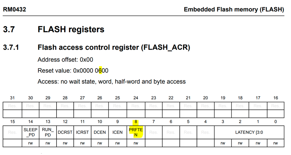

> Does anybody know if there is any prerequisite when enabling or disabling the prefetch buffer?
The RM just says to set/reset the bit, and that's all the ST examples do.
> Since the prefetch buffer is enabled at reset
PRFTEN = 0 at reset, at least per the RM.
