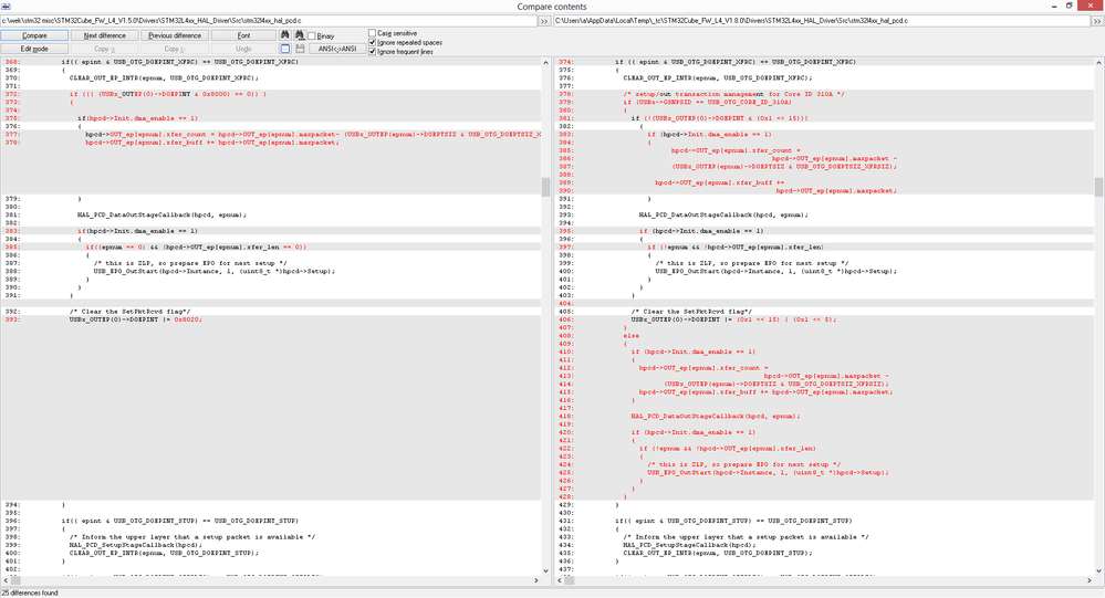

Meantime, things got worse. I am mostly interested in answer on question nr.4 the mysterious bits in DOEPINT.
Comparing old and new (v1.8) CubeL4:
And of course, not a iota of the Core ID register, or bits 5 and 15 in DOEPINT, in RM0351, as of now rev.5.
