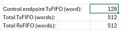

Upon further review, your RxFIFO setup is indeed correct. I realize I may have overstepped in the initial investigation. The root cause of the issue is more likely related to the TxFIFO configuration.
Total TxFIFO size is 512 words, any adjustment to the control endpoint’s TxFIFO size must be carefully considered to avoid impacting overall FIFO allocation.
As I don't have your full SW setup, try to decrease TxFIFO . As I mentioned earlier, this article might be helpful. Some practical use cases are provided here for help.

Sorry for the misunderstanding, your configuration for RxFIFO is definitely correct. However, try to dispatch the TxFIFO to the control EP0 and EP1 as follows:
/* Set Rx FIFO to accommodate 512 words*/
HAL_PCDEx_SetRxFiFo(&hpcd_USB1_OTG_HS, 0x200);
/* Set Tx FIFO 0 size to 16 words (64 bytes) for Control IN endpoint (EP0). */
HAL_PCDEx_SetTxFiFo(&hpcd_USB1_OTG_HS, 0, 0x10);
/* Set Tx FIFO 1 to 256 words (1KB) for Bulk IN endpoint */
HAL_PCDEx_SetTxFiFo(&hpcd_USB1_OTG_HS, 1, 0x100);
If this configuration works well, we can proceed and have a clearer focus to narrow down the root cause.
