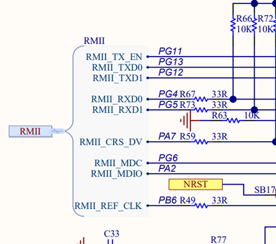

Hello @Vidar,
I understand your frustration. After reviewing your MX configuration, I noticed that your GPIO mapping for Ethernet does not align with the schematics for the Nucleo board. I suggest you try remapping the pins as shown in the screenshot below and try again.

Thanks so very much, I got the Ethernet working!
But honestly, why is that even possible? Shouldnt the RMII Pins be fixed for the Nucleo board? Even though there is no severe issue and you cpuld, including myself, RTFM, it would be way consumer frendlier if it would be fixed or an error occurred, as you can select the devboard in CubeMX?
