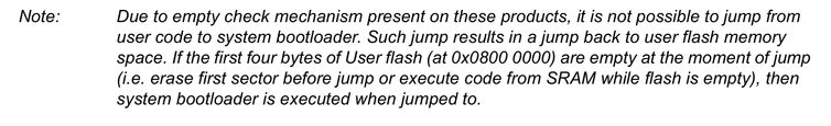

AN2606 note
can ST publish code part and jump adress to fake this limitation? In real world must exist.

The bootloader can be read out/disassembled/debugged.
2024-05-13 7:47 AM
In the real world you'd typically write your own loader, as the system loader is mainly for factory programming or bricked recovery. It's really not designed for an End User Experience
One could presumably determine secondary entry points, or patch the ROM
