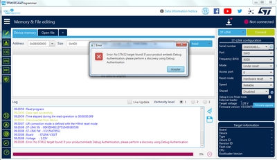

Now, with nBOOT1=1, nBOOT0=1, nBOOT_SEL=0, I was able to flash from bootloader every time that BOOT was high, which is what I wanted. The issue was that when I tried to connect from SWD to develop the rest of the project, I found that I was unable to connect from SWD. I tried everything: connect from under reset, power down, core, software and hardware reset and it was impossible.

Why can't you connect with SWD? What happens when you try? Unless you are erasing/programming flash, reassigning SWD pins, or otherwise, the connection will work. If the chip is in the bootloader, you can connect with SWD. No way to disable SWD apart from setting RDP level 2.
2025-07-08 5:32 AM
When I try with STM32CubeProgrammer, it shows this:
Before changing nBOOT_SEL to 0 and flashing, I was able to connect normally. I have not changed the RDP level at any point
