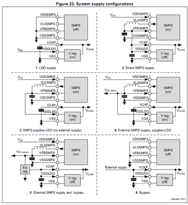

Please check the following:
1 - The hardware configuration of the STM32H755: LDO, SMPS or what else?
From RM0399:
The firmware configuration of the power should reflect the hardware.
2 - Did you enable any of the flash protection features in option bytes ?
From RM0399:
2024-05-13 1:57 PM
Yes, I found the problem. System supply configuration was wrong...
