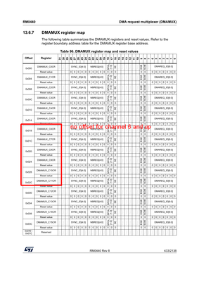

2025-01-19 1:36 AM
The debugger also shows the registers, that are not present. This is what me got into thinking, that the lib was wrong.
2025-01-21 3:24 AM

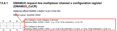

Hello @waclawek.jan and @Tobe,
After check, Table 96. supports only DMAMUX register map and reset values for category 3 and category 4 devices.
A new table should be added in the coming revision to support DMAMUX register map and reset values for category 2 devices. This new table will be on line with https://github.com/STMicroelectronics/cmsis-device-g4/blob/master/Include/stm32g431xx.h
- Addresses: 0x014 and 0x018 should be reserved
- DMAMUX_C8CR... DMAMUX_C13CR should be renamed to DMAMUX_C6CR... DMAMUX_C11CR
- Addresses: 0x038 and 0x03C should be reserved
->Btw. there are other STM32 with DMAMUX with similar "non-8-channel-per-DMA" scheme, so can you please comment on those, too

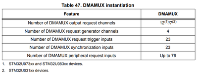

Could you please give an example of STM32MCUs with non-8-channel-per-DMA (supports DMA1 and DMA2 with non-8-channel?
- For example STM32WBx5 MCUs support 14 channels
DMAMUX is used with DMA1 and DMA2:
• DMAMUX channels 0 to 6 are connected to DMA1 channels 1 to 7
• DMAMUX channels 7 to 13 are connected to DMA2 channels 1 to 7
- STM32U031 MCUs support only DMA1 and 7 of DMAMUX output request.
- STM32MP1 supports 8-Channels-per-DMA
->The debugger also shows the registers, that are not present.
Thank you for bringing this issue to our attention. I reported internally.
Internal ticket number: 200921 (This is an internal tracking number and is not accessible or usable by customers)
Thank you.
Kaouthar
