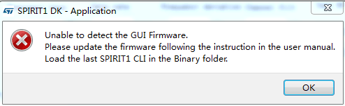

i met a big problem, now i am using Nucleo L073RZ board and x-nucleo-ids01a5 expansion board to do the point to point communication. i want to use SPIRIT1 DK to receive and analyse the data. however, i can not open the com, it always shows the below figure, but my virtual ports have been installed correctly. could you please help me.

Dear D:
