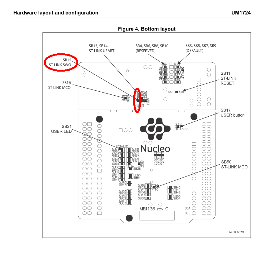

PB3 is the SWO pin and is connected to the on board STLink.
remove SB15 if you want to use it in your application.

Thank you for your answers, just two questions for my knowledge:
1- what is SB15? (yes I know I'm just new on nucleo)
2- Is it possible to desactivate the swo on the pb3 port and using another port connected to the stlink but on 'external device' connector?
2017-05-16 5:25 PM
It is a Solder Bridge (basically a jumper using solder), you'd need to use a soldering iron and a solder wick or sucker to remove the solder an open the circuit.
PB3 has defined functionality related to the debug interface, it can't use a different pin. The SWV (Serial Wire Viewer) it helps implement is optional. You will likely need to Remap the JTAG/SWD interface to use just the minimal SWDIO/SWCLK pins.

what is SB15?
SB stands for Solder Bridge, although in reality you'll find tiny 0-Ohm resistors soldered onto those which are by default shorted.
