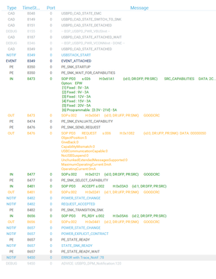

I successfully compiled and flashed the firmware onto my NUCLEO-G071RB board. When I tried connecting my setup (NUCLEO-G071RB + X-NUCLEO-SNK1M1) to an external monitor via USB-C to test the power delivery negotiation, I encountered an issue: `ERROR with Trace_Notif :78`.
The issue can be caught when debugging using STM32CubeMonitor-UCPD.
I've attached the whole trace.

Here is the zip of the whole project + traces with another source device.
The ERROR happens when I plug the cable from laptop/monitor to snk1m1.
Update on the project:
The PD part works, but the source of the ERROR trace is still unknown. The error message is some kind of a timeout but the question remains, why does it trigger?
