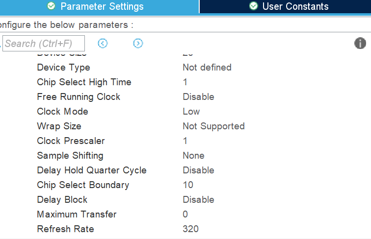

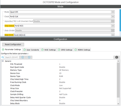

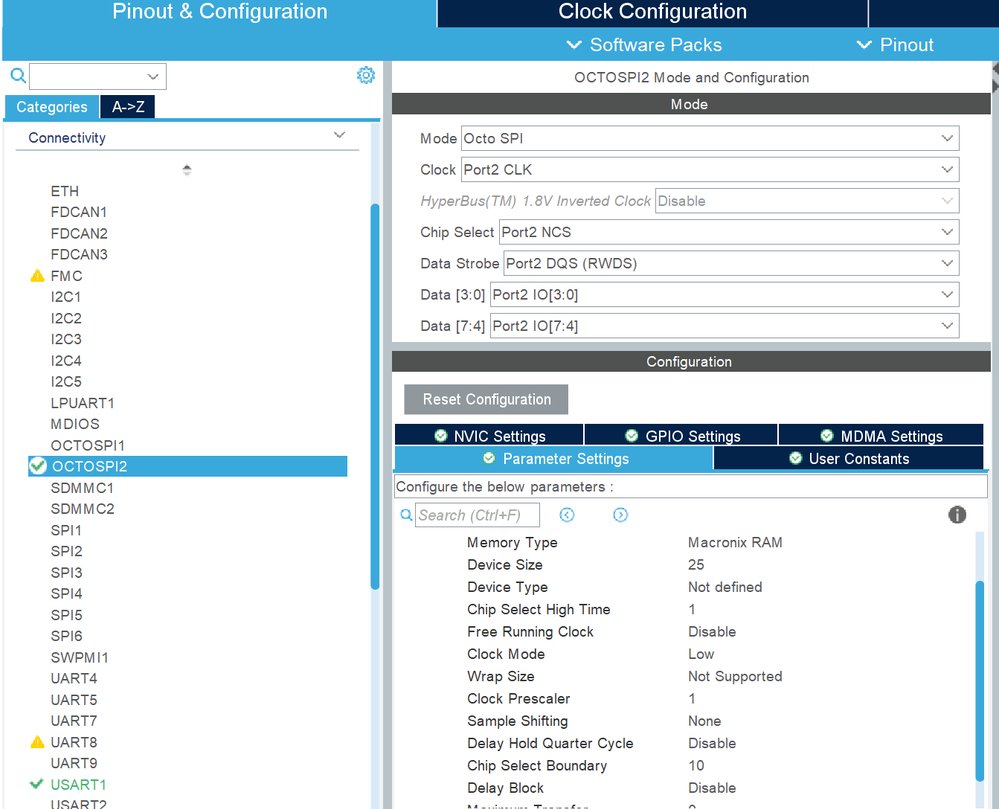

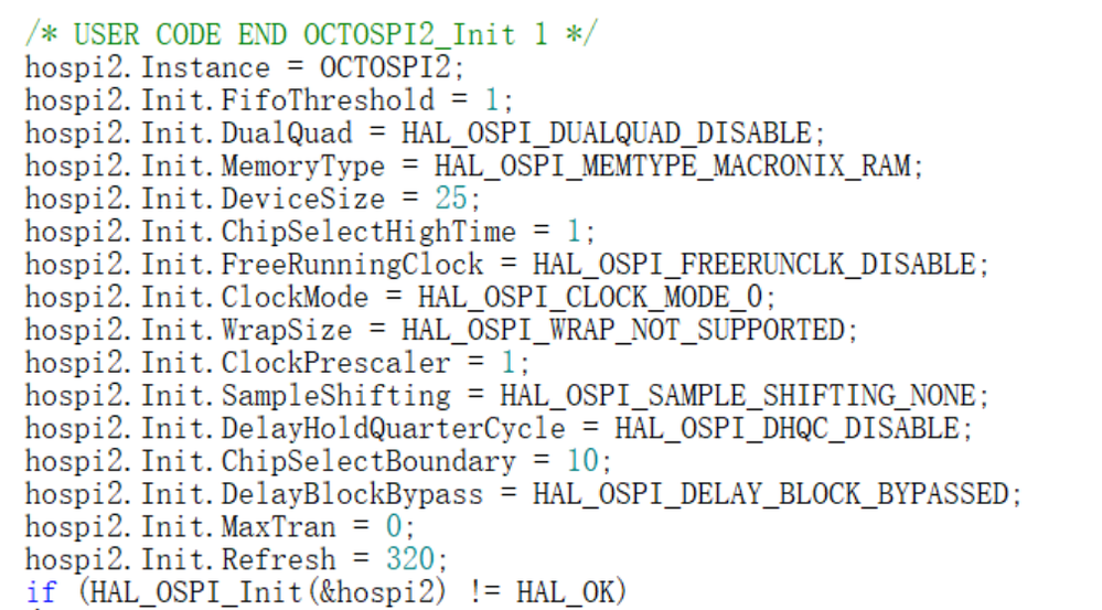

1、The first step is to use cubemx to configure OSPI interface parameters as shown in the following figure:

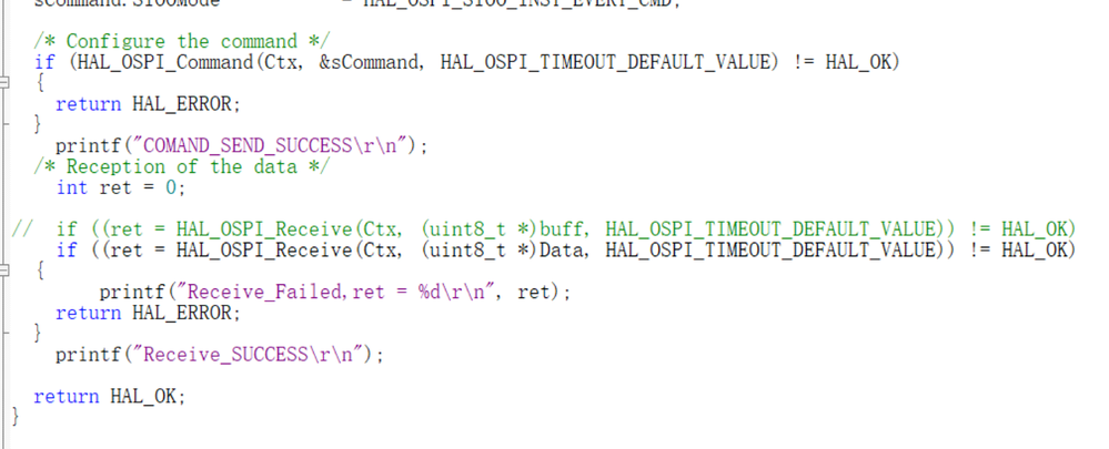

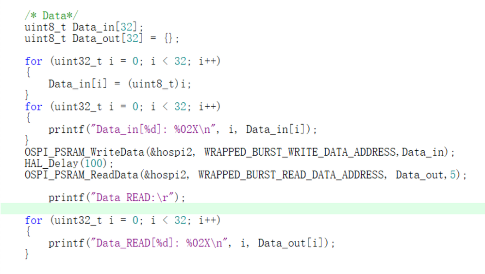

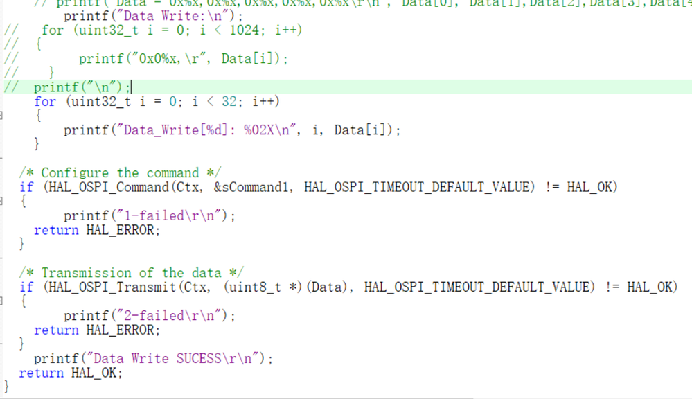

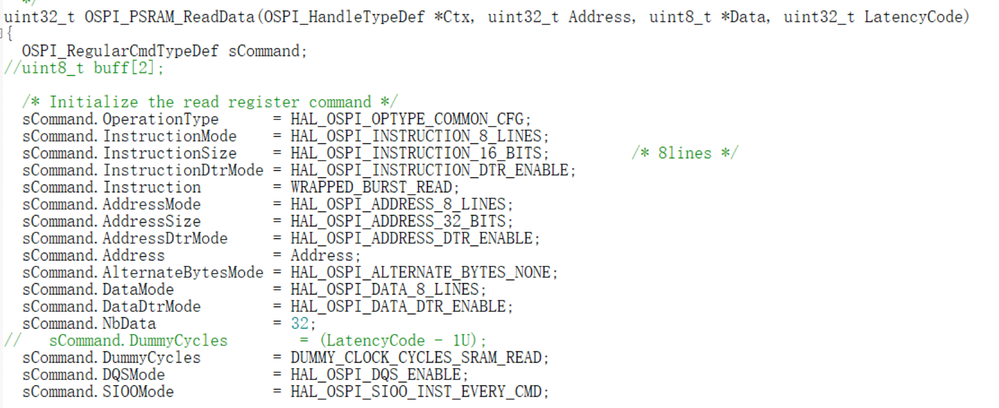

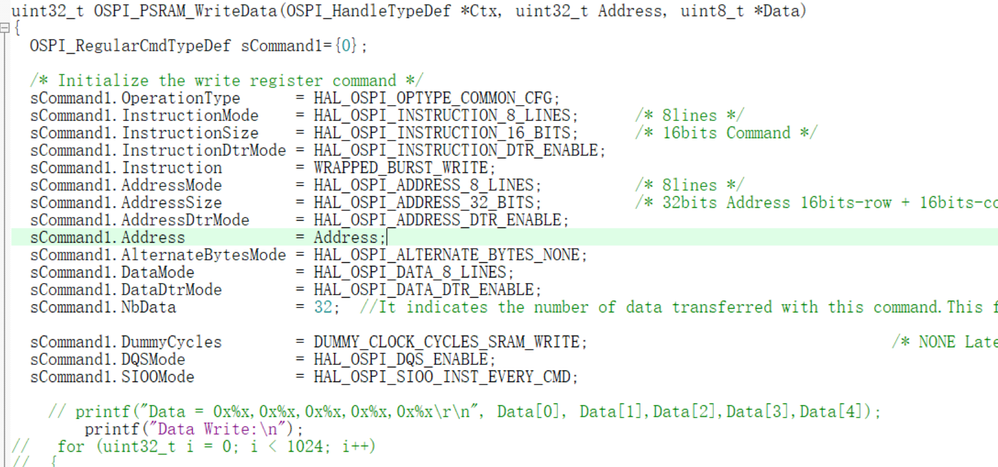

2、The second step is to define the data read and write command parameters with OSPI_RegularCmdTypeDef:
1.here the write data is 32 bytes and the data is printed out through the serial port
2.here read the 32 bytes of data written above

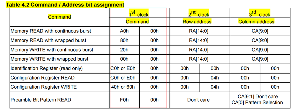

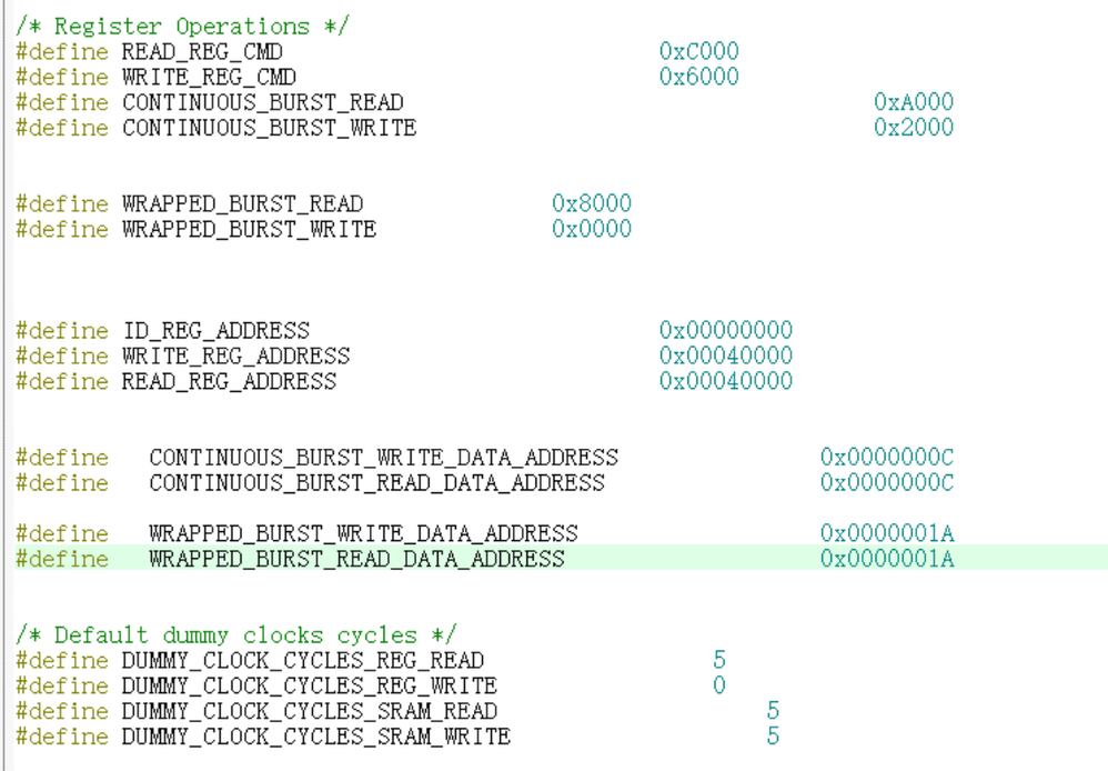

3.The following are the address and instruction parameters for the call, as defined by ISS66WVO32M8DBLL:

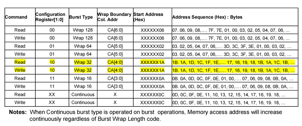

Use wrap burst mode

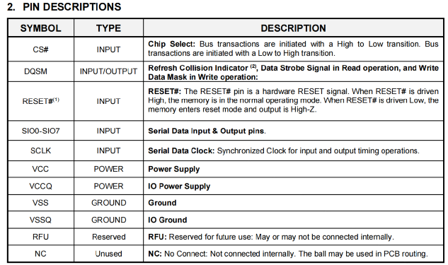

3、I have a few things to add about ISS66WVO32M8DBLL
1.DQSM operates as a data mask when data is written to memory;
2.DQSM acts as the data synchronization clock when data/registers are read;

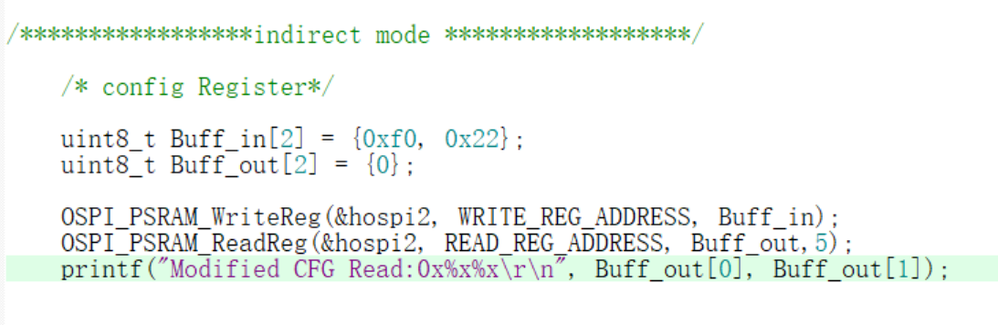

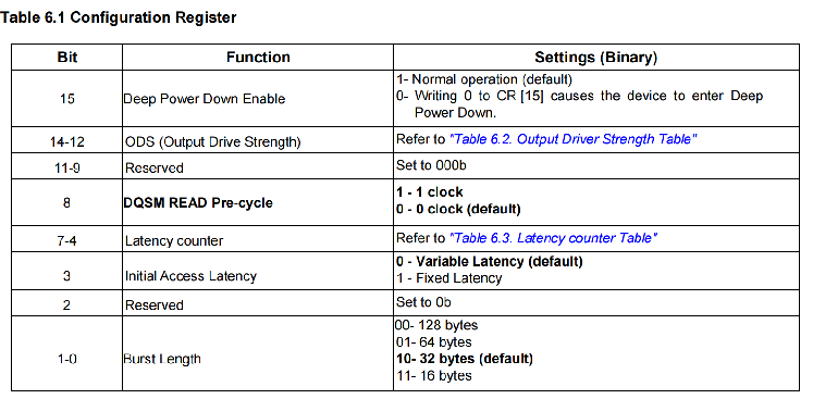

1.Default value: 1111 0000 0010 0010 :0xf022
2.CR[3] Initial Access Latency: When used in conjunction with Latency counter, the multiple of Latency counter is determined. When this bit is 0, the multiple is determined according to whether there is Refresh Collision (Refresh collision means that a read or write operation is performed at the same time during a refresh operation, which may result in performance issues or data errors). Decide that if there is a refresh conflict, it will be twice, and if there is no refresh conflict, it will be 1 times. When this bit is 1, it is fixed to double.

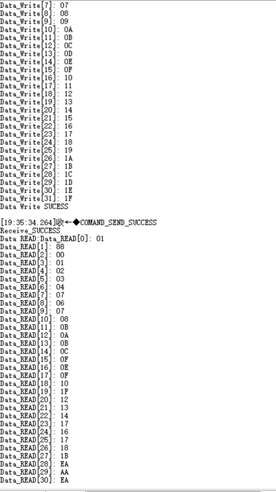

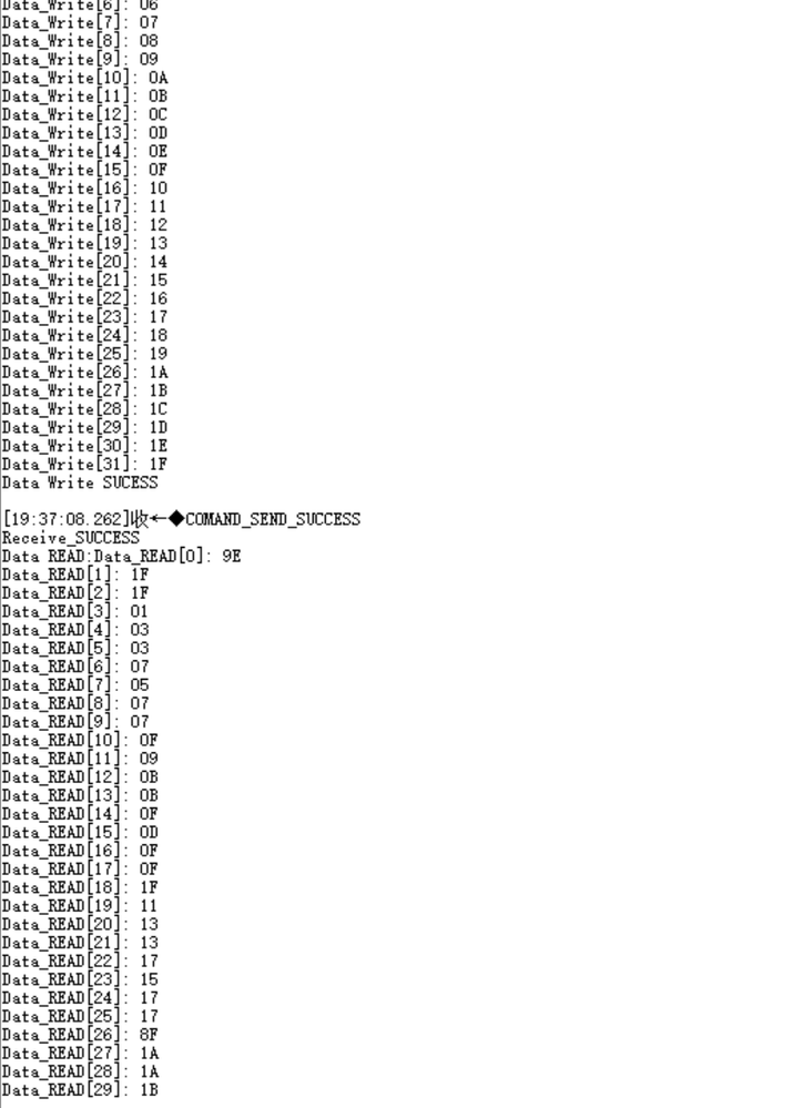

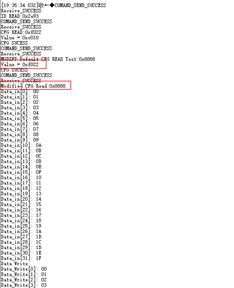

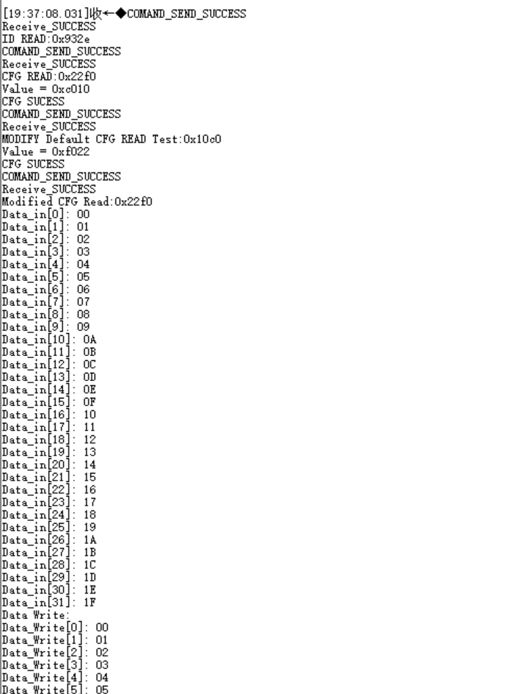

4、The third step, call the above function, the address and data passed in, but the actual print results, read the data is wrong:
The above code is to write 32 bytes of data to memory, read it into the array, and print it out through the serial tool.
The results are as follows:
Without changing the memory type (originally AP Memory), the register reads correctly but the memory reads and writes incorrectly,
and after changing to Macronix RAM, the register reads and writes incorrectly:
I think there may be an error in the register configuration, hope you can answer the doubts, thank you very much!

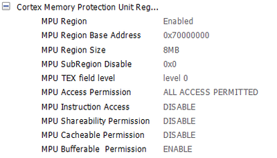

Here is my code for "APS6404L-3SQR-SN" in H723. Remember to config your MPU correctly.

Thank you for your reply. I have tried APS PSRAM, and I can read and write normally according to its official example, but ISSI's cannot run at present. And I did not use MPU in the application process, is ye to be enabled?

Hello @Lin_Yishan ,
Could you please refer to How to set up the OSPI peripheral to interface with the IS25LX256 from ISSI and get inspired to check your OCTOSPI configuration (Device type, Delay hold quarter cycle ....).
AN5050 Table 8. STM32CubeMX - Configuration of OCTOSPI parameters explains how to configure the OCTOSPI parameters depending on the memory used.
I hope this help you.
