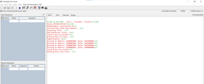

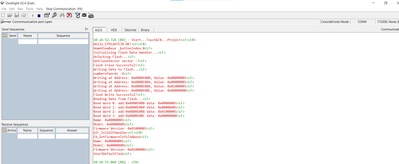

2025-02-19 8:05 PM - edited 2025-02-19 10:50 PM
Thanks for all your help!
Using the start address 0x0800E000 fixed my issue, and the code is no longer getting stuck.
However, I noticed that the second word is always being read incorrectly. Below is the attached screenshot of my log.
I tried with different values but there is always unnecessary 4 come in value.
/Mehul

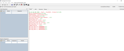

2025-02-20 2:20 AM
While trying to write different values i found that writing
FH_FLASH_DATA_INFO flash_data_write =
.name = 0x01000001,
.model = 0x01000001,
.firmware_version = 0x01000001,
};above values cause my code stuck.

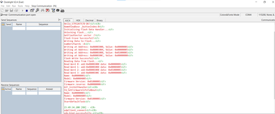

here is screen shot of log,
Again if i tried with this value it is running but still comes 4 in value,
.name = 1,
.model = 5,
/Mehul
