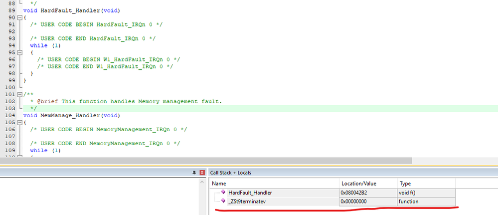

And the when I stop the crashed program. It like below.
2020-09-23 6:25 PM
How can I find the cause of hard fault.
In keil ,I only find the hard fault like below.
