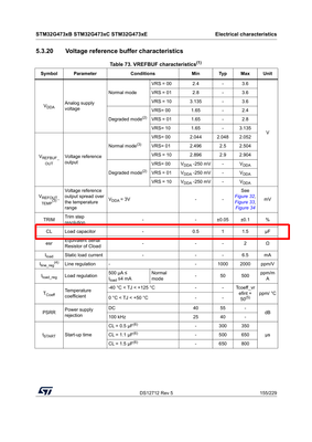

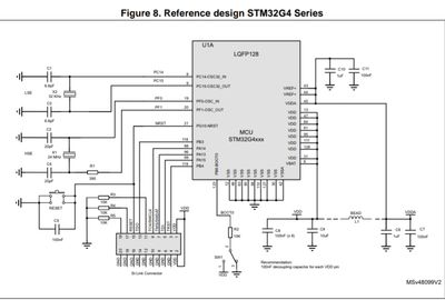

> Is this documented anywhere?
Sure.
Importance of stable VREF+ for stable DAC is not a question, I suppose.
