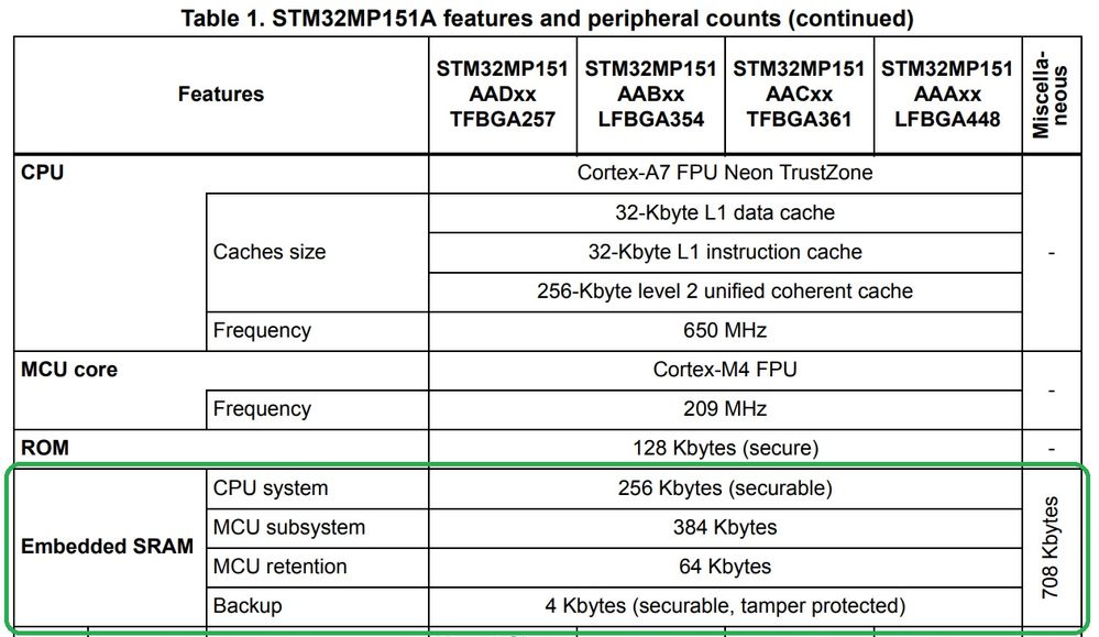

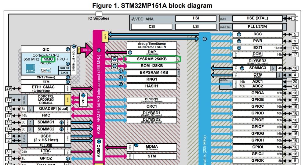

Thanks! I've seen STM32MP151 series, but wasn't sure if that embedded SRAM was tied to Cortex-A7 or Cortex-M4 (I thought since Cortex-M series that I saw usually had ~300KB or internal SRAM alone, it was something like that which is shown in the datasheet).
From this diagram I guess my impression was wrong and both CPU can access the internal SRAM. Thanks!
