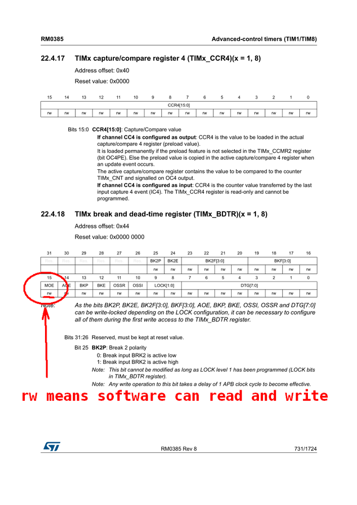

Doesn't using CHx from advanced timer require to enable it also by setting TIMx_BDTR.MOE?
2020-01-30 2:41 PM
I don't claim to understand it, but it would seem to me like maybe that is about GPIO outputs? I tried it here, setting the AOE bit, It doesn't go, it must be something else.
2020-01-30 4:27 PM
I said, MOE, not AOE.
Read back and check the content of timer and ADC registers.
You may also want to try a different timer, some of the "general purpose" ones.
2020-01-30 4:42 PM
Not sure what to say, the datasheet says MOE not directly writeable. Anyway, readback does show MOE on. Or, perhaps there is some nuance I'm not getting.
Unfortunately, I am already using timer this to dma pwm gpio, and it really needs to be synchronized to it.
2020-01-31 2:03 AM
Then you must have a different datasheet (here: Reference Manual) than I have.
Anyway - read out and check all TIMx registers. Check that it's running and generating a waveform on the given channel - assign it to an appropriate pin in GPIO and observe using oscilloscope.
Read out also the ADC registers and check if they are properly set.
