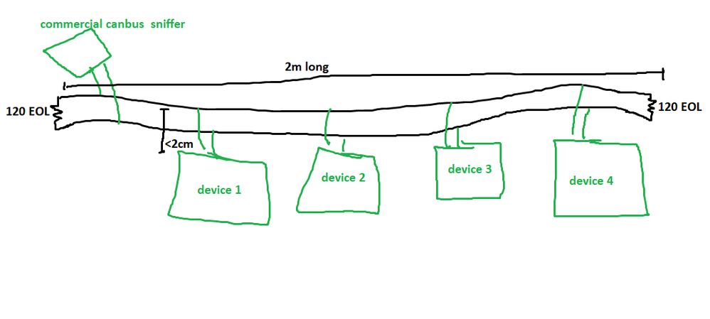

My setup consists in 4 identical nodes hooked up to a 2m long canbus.

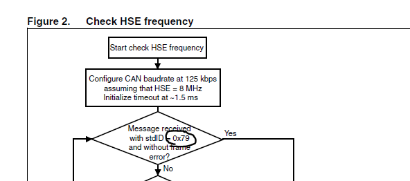

I found this note in the AN3154 appnote
I dont use more than one node at a time....

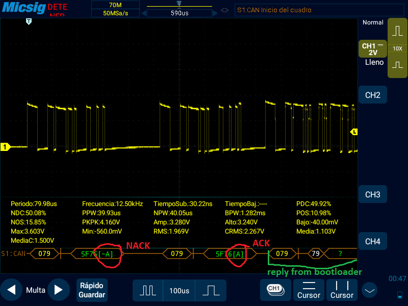

2021-02-22 9:12 AM
I just found another person with my same bug two years ago.
And while sniffing the bus i think i figured it out, for some silly reason the bootloader is expecting the first 0x79 command to be NACKED and only after that reply to the next 0x79 command.
If you send the 0x79 only once (automatic resend disable) the bootloader doesnt work either
