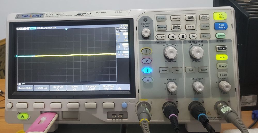

I don't see anything wrong with that code.
Plain blinky (i.e. setting PA7 as GPIO Output, and then toggling it in a loop using a loop-delay) works?
PS. You can post code using the </> icon at the top of editor.
2024-07-27 12:48 AM
You should learn about, how to use/set a scope first.
-> set probes to 10:1 and adjust them.
2024-07-27 1:36 AM
Next bare metal musician. You know what RISC exactly mean?
And debuger peripheral view ? And your code for better reading
