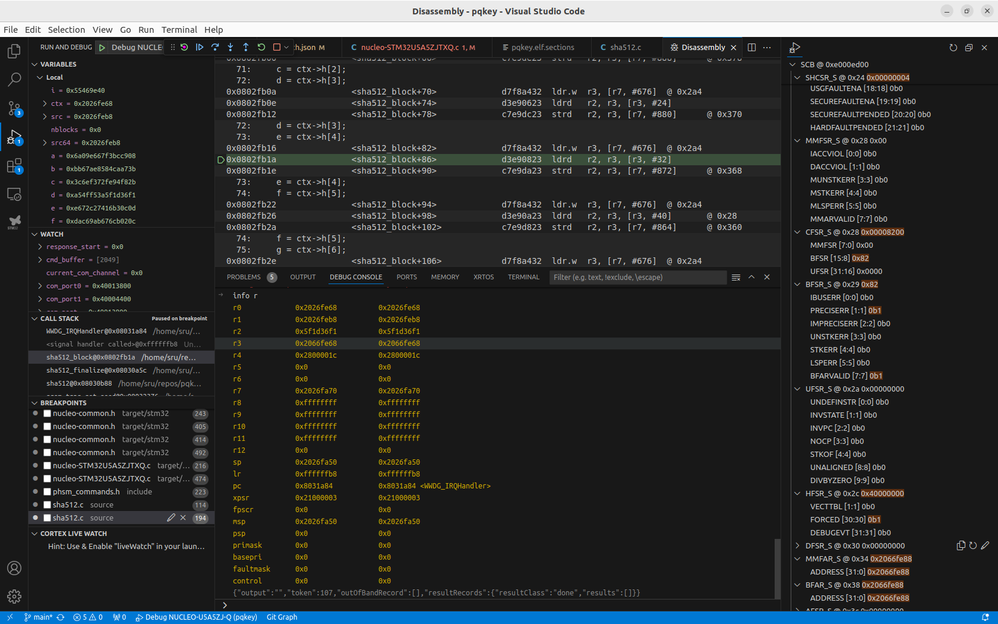

I execute my program on unmodified nucleo-u5a5zj-q , it reliably reach the "Default_Handler" from the default startup_STM32U5A5ZJTXQ.s.
My understanding from the screenshot:
One or more points above may be wrong since the conclusion makes no sense

LDRD/STRD are sensitive to alignment issues for the pointers
If a random interrupt, perhaps check source via NVIC
Check VCAP voltage and capacitors, these can cause sensitivity and failure issues. Certainly seen FLASH issues with insufficient bulk capacitance.

The address of the faulty address seems well aligned isn't it ?
I believe that if the fault was due to an interrupt, the fault status registers would point to the interrupt code. Anyway my code do not have interrupt so I disabled them by setting PRIMASK=1, the same hardfault still occurs.
The STM32_Programmer_CLI tool indicates 3.29V, that seems well within the specs (I use brand new, unmodified nucleo board). I searched for "VCAP" in the nucleo doc but did not find it. Is there anything else I could check ?
