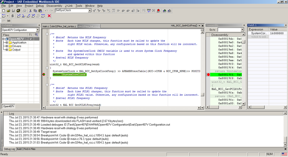

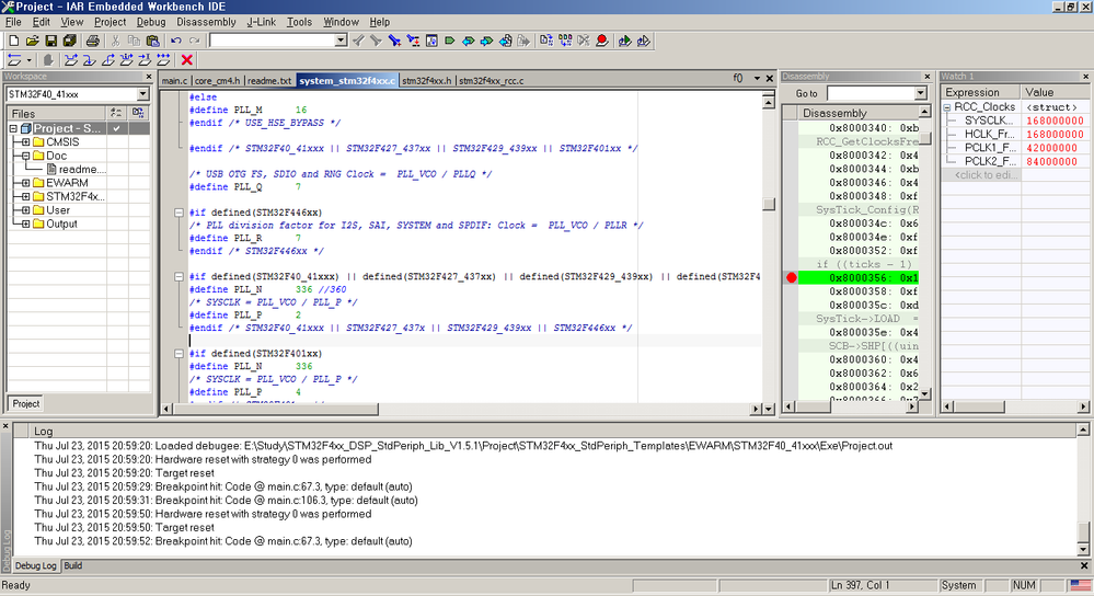

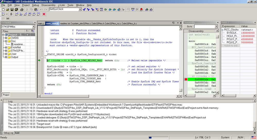

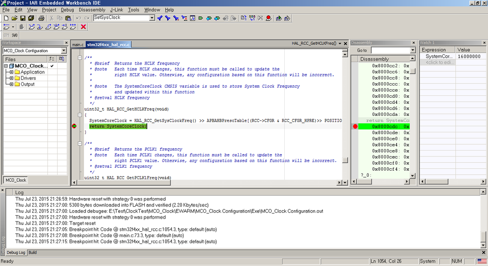

I tested again with my system. - STM32F4-DISCOVERY - Third Party Development KIT - My custom board 1. The generation code for STM32F4-Discovery works well. The system clock value is 168M. 2. The generation code for third party dev kit does not show the Max Speed 168M. just only 16M. However, STM32F4-Dicovery show the max speed 168M. The modified standard peripheral library code for third party dev kit works well. (just only the HSE_VALUE as 8M, PLL_M as 8, and PLL_N as 336) 3. The generation code for my custom board does not show the MAX Speed 180M. also just 16M. However, the Standard Peripheral Library code works well in my custom board. The system clock speed show 180M. (HSE_VALUE as 26M, PLL_M as 26, and PLL_N as 360) The following is my capture of the system clock speed. - CubeMX generated Code for Third Party Dev Kit2015-07-23 6:25 AM
Are we sure it's actually running from the HSE or PLL?
The number suggests that it's running from the HSI. So I'd go look if there are any errors returned by the function. And then go look at the RCC registers and decompose the actual settings the system is running with.2015-07-23 7:47 AM

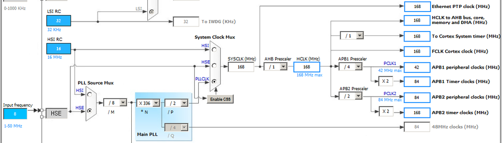

Please use the same configuration as in this figure

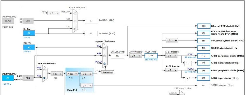

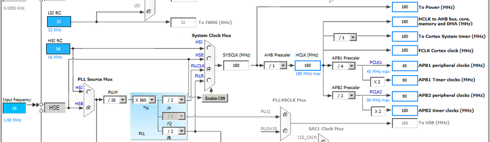

This is my clock configuration for CubeMX.
Do you want this configuration?
I wonder that the difference between Discovery and tird party development kit. - Clock Configuration for Third Party Dev Kit- Clock Configuration for Custom Board
