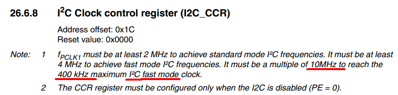

In reference manual RM0008 they had written, for i2c fast mode operation i2c clock frequency must be a multiple of 10MHz. To achieve this I had set SYSCLK 40MHz (HSE: 8MHz and PLL :5). Configured Duty bit as 1(in I2C_CCR register,Actually I didn't understand yet the purpose of duty bit. I have attached the images from RM0008) . I had tested with this configuration and I was able to get fast mode I2C frequency(400KHz ).

Having 10MHz multiple at Pclk is only required to reach 400KHz exactly. Because the IIC in 16/9 duty mode requires 400Hz*(16+9)=10MHz input clock. Apparently the clock tree cannot generate that.
With another pclk speed, you can either run slower than 400KHz or change duty to 2/1. It will maybe run out of II2 fast mode spec but can be possibly supported by your slave device.
With 36MHz Pclk, duty 16/9, CCR=4, the speed should be 360KHz.
With 36MHz Pclk, duty 2/1, CCR=30, the speed should be 400KHz.

Thankyou... this is helpful ...I want to test using this configuration by updating I2C_CCR register. So as per my understanding to reach exact 400KHz multiples of 10MHz need to use for I2C clk. By 36MHz I2C clk(pclk1) by adjusting CCR value we are able to reach around 400KHz not exact. Is this correct?

For 400KHz exact we should use I2C clk as a multiple of 10MHz. And to achieve around 400KHz( May a greater value or lesser value but near to 400KHz) by changing CCR values in I2C_CCR register (What
