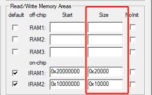

Hello @Passerby ,
how did you modified the upper limit of RAM in Keil?
I am using Keil5 too.

Options For Target -->Read/Write Memory Areas --> Size     , Change it to bigger
