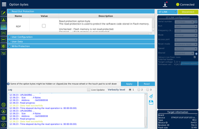

all cpu have it..
just open CubeProgrammer and you can see:
2024-07-13 3:39 AM - edited 2024-07-13 3:40 AM
all cpu have it..

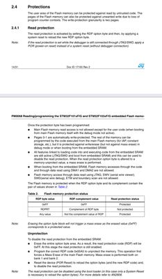

Dear @DavidKean ,
Welcome in STCommunity ! To complement Ascha.3 message , Our flash protection procedure is specified here for STM32F103 MCUs
This was our first STM32 MCU launched in 2007 , and by time we added more features for security and protection - latest one is on STM32H5 series which is only the new cousin for the F103 series .
