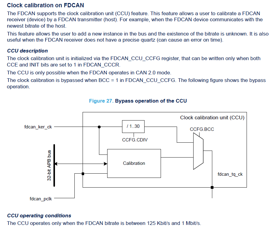

I have to connect my STM32H7 board to a network with unkown parameters. Is it possible to use the FDCAN Clock calibration Unit (CCU) to do an automatic baud rate detection of the arbitration phase.

Could you use Clock Calibration for this?
