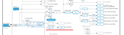

If ADC is using Asynchronous Clock Mode and prescaler is set to 64, then starting ADC right after calibration without delay fails. Other prescaler values work fine:
