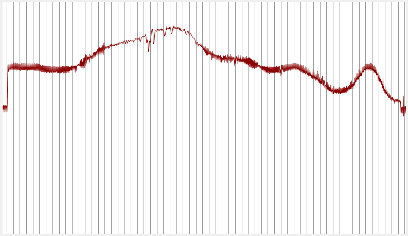

2021-08-03 7:33 AM
I dont doubt them per say but i doubt my implementation of them.
As seen in the attached picture i get noise at the ends of my signal but not in the middle. This is despite the measured noise being uniform switching noise that persists throughout the signal. My current hypothesis is therefore that the ADC and the Timers are running at slightly different frequencies as this pattern persists over multiple measurements. Ive also checked the generated timer signals and they run consistantly at the specified frequencies with very low deviation.
This is why i wanted to generate a signal that indicates the start of each ADC sample to visualize and possibly solve the problem.
