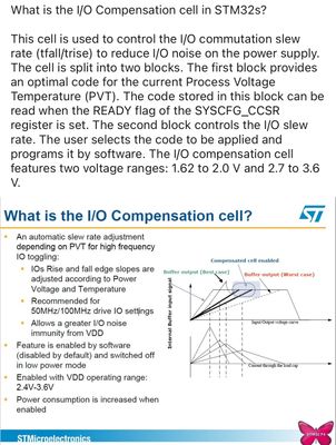

We introduced I/O compensation cell for our first 90nm Process technology for STM32F2 and F4 and then we maintained it for high speed and high performance lines such as H7 and recent platforms. Basically we can summarize this feature ( design process - not easy to see the impact for typical devices ) that it operates in opposite way as I/O digital Output speed and will reduce and compensate the fast process ( fast transistors) in automatic way for user . For more details see this slide 8

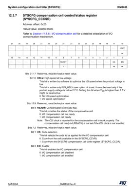

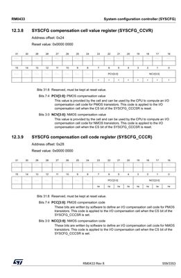

thanks for the clarification, indeed here is how te set them in the reference Manual ,
My recommendation for software to rely always on the hardware automatic way , the manual one can be used only for debug purposes as each code is part to part dependent and acts on each Unique MCU in a different way based on the PVT ( Process, Voltage and Temperature) to keep controlled skew rate . After reading the automatic way , we can then change the Code ( Read only ) with increment/ decrement as see the effect .
hope now more clear .
