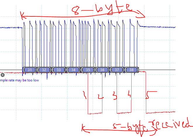

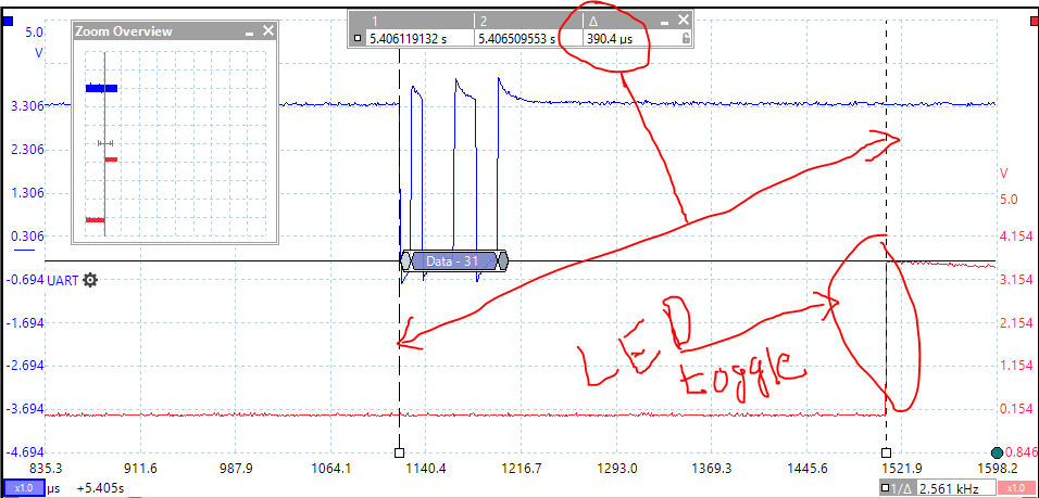

Let me start with your example, all good and every thing works as you mentioned when you send data byte by byte(aprox 278us delay between bytes), but the problem occurs when send continues bytes(long string). 1st the current shouts up 2nd radio stops. beauty is the LPUART will be still receive bytes(FOR the above example I even received a \r** STOP ADVERTISING **\r\n msg).
Delay between Byte and LED toggle in BLE_p2pServer_LPUART_STOP2 project
For 8 bytesBLE_p2pServer_LPUART_STOP2 project with delay between each toggle ~85us

Lets say I send 0x01 0x02 0x03 0x04 0x05 0x06 0x07 0x08 0x09 0x10 for 5 times so total 50 bytes it receives 03-05-07-09-10-03-05-07-08-09-10-03-04-05-06-09-10-03-05-07 around 22 bytes. without affecting CM4/CM0 usual routine.
Than I tried enabling FIFO the performance improved, There is no packet drop for 1st 8-bytes also, As long as I send 8-byte string with small delay between them every thing works well. If the string length is more than 8 bytes the a byte drop again.
For 0x01 0x02 0x03 0x04 0x05 0x06 0x07 0x08-------> x5times ****ALL GOOD AND received 40 byte****

For 0x01 0x02 0x03 0x04 0x05 0x06 0x07 0x08 0x09 0x10-------> x5times ***PACKET DROP OBSERVED***

So currently I'm at this point, With all your settings/**/changing LPUART priority/**/Not using DMA for TX/**/ above are my observation.
What dose LL_EXTI_EnableIT_0_31(LL_EXTI_LINE_25); actually means. From where have you got this reference.
Why is this packet drop happening?
Can you suggest me any next step...

One of the things done in Stop mode exit routine is starting HSE oscillators which takes about 250us. This is enough to create overrun condition on LPUART RX when characters are send back to back. At Baud rate @115200 the character length is approximately 86us.
I modified the example so that it uses the internal RX FIFO, which can buffer up to 8 characters. In the LPUART RX callback (ISR context) a task is set (background context) which pus the received characters in a queue and sets up another LPURT reception. LPUART RX callback sets also second task (background context) which process the incoming data and echoes them back on LPUART TX once a New line character is found. I also configured a few GPIO debug signals to verify the timing with logic analyzer. Can you please test the code and let me know if you see any issue with it?
Best regards,
Martin
