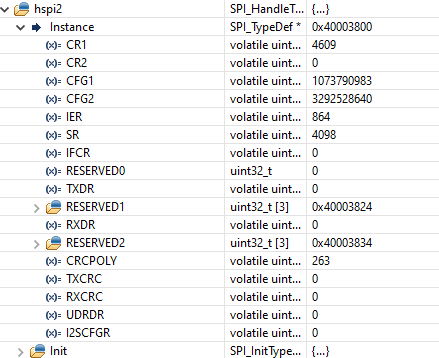

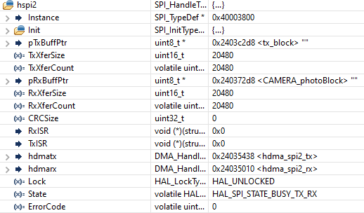

I am trying to use SPI and DMA in a STM32H7, but it is not worling. The spi handler goes to "HAL_SPI_STATE_BUSY_TX_RX" state as soon as i call the function "HAL_SPI_TransmitReceive_DMA" and it does not do anything, it does not even generate the clock signal. The CPU IChache and DCache are disabled and MPU is not used. Besides, i have placed all the memory sections in "RAM_D1" as you can see in the linker attached.
I have tried placing the DMA buffers in another memory section and place this in "RAM_D2". Besides, i have also tried aligning these buffers with "ALIGN_32BYTES", and using different DMA streams but the result is always the same.
I would really appreciate any help, i am really stuck into this.

SPI initialization:
hspi2.Instance = SPI2;
hspi2.Init.Mode = SPI_MODE_MASTER;
hspi2.Init.Direction = SPI_DIRECTION_2LINES;
hspi2.Init.DataSize = SPI_DATASIZE_8BIT;
hspi2.Init.CLKPolarity = SPI_POLARITY_LOW;
hspi2.Init.CLKPhase = SPI_PHASE_1EDGE;
hspi2.Init.NSS = SPI_NSS_SOFT;
hspi2.Init.BaudRatePrescaler = SPI_BAUDRATEPRESCALER_32;
hspi2.Init.FirstBit = SPI_FIRSTBIT_MSB;
hspi2.Init.TIMode = SPI_TIMODE_DISABLE;
hspi2.Init.CRCCalculation = SPI_CRCCALCULATION_DISABLE;
hspi2.Init.CRCPolynomial = 0x0;
hspi2.Init.NSSPMode = SPI_NSS_PULSE_ENABLE;
hspi2.Init.NSSPolarity = SPI_NSS_POLARITY_LOW;
hspi2.Init.FifoThreshold = SPI_FIFO_THRESHOLD_01DATA;
hspi2.Init.TxCRCInitializationPattern = SPI_CRC_INITIALIZATION_ALL_ZERO_PATTERN;
hspi2.Init.RxCRCInitializationPattern = SPI_CRC_INITIALIZATION_ALL_ZERO_PATTERN;
hspi2.Init.MasterSSIdleness = SPI_MASTER_SS_IDLENESS_00CYCLE;
hspi2.Init.MasterInterDataIdleness = SPI_MASTER_INTERDATA_IDLENESS_00CYCLE;
hspi2.Init.MasterReceiverAutoSusp = SPI_MASTER_RX_AUTOSUSP_DISABLE;
hspi2.Init.MasterKeepIOState = SPI_MASTER_KEEP_IO_STATE_ENABLE;
hspi2.Init.IOSwap = SPI_IO_SWAP_DISABLE;
if (HAL_SPI_Init(&hspi2) != HAL_OK)
Error_Handler();
}DMA initialization:
/* DMA controller clock enable */
__HAL_RCC_DMA1_CLK_ENABLE();
__HAL_RCC_DMA2_CLK_ENABLE();
/* DMA interrupt init */
/* DMA1_Stream0_IRQn interrupt configuration */
HAL_NVIC_SetPriority(DMA1_Stream0_IRQn, 0, 0);
HAL_NVIC_EnableIRQ(DMA1_Stream0_IRQn);
/* DMA1_Stream3_IRQn interrupt configuration */
HAL_NVIC_SetPriority(DMA1_Stream3_IRQn, 0, 0);
HAL_NVIC_EnableIRQ(DMA1_Stream3_IRQn);
/* DMA1_Stream4_IRQn interrupt configuration */
HAL_NVIC_SetPriority(DMA1_Stream4_IRQn, 0, 0);
HAL_NVIC_EnableIRQ(DMA1_Stream4_IRQn);
/* DMA1_Stream5_IRQn interrupt configuration */
HAL_NVIC_SetPriority(DMA1_Stream5_IRQn, 0, 0);
HAL_NVIC_EnableIRQ(DMA1_Stream5_IRQn);
/* DMA2_Stream2_IRQn interrupt configuration */
HAL_NVIC_SetPriority(DMA2_Stream2_IRQn, 0, 0);
HAL_NVIC_EnableIRQ(DMA2_Stream2_IRQn);
/* DMA2_Stream3_IRQn interrupt configuration */
HAL_NVIC_SetPriority(DMA2_Stream3_IRQn, 0, 0);
HAL_NVIC_EnableIRQ(DMA2_Stream3_IRQn);Call to transmit/receive through DMA:
uint8_t tx_block[20480+1] = {0};
void SPI_StartGetBlock(SPI_HandleTypeDef *spiHandler, char *block, uint32_t size)
HAL_StatusTypeDef status;
uint8_t retry;
const uint16_t attempts = 10;
if (size > 20480) return;
do
status = HAL_SPI_TransmitReceive_DMA(spiHandler, tx_block, block, size);
retry++;
if (retry>attempts) {
return;
} while (status!=HAL_OK);
return;
}Buffer where RX info would be stored, defined as global:
uint8_t CAMERA_photoBlock[CAMERA_MODEL_PHOTO_BLOCK_SIZE];DMA interrupts in stm32h7xx_it file, that are never executed:
* @brief This function handles DMA1 stream3 global interrupt.
void DMA1_Stream3_IRQHandler(void)
/* USER CODE BEGIN DMA1_Stream3_IRQn 0 */
#ifdef CAMERA_ARDUCAM
CAMERA_RxFromCameraComplete();
#endif
/* USER CODE END DMA1_Stream3_IRQn 0 */
HAL_DMA_IRQHandler(&hdma_spi2_rx);
/* USER CODE BEGIN DMA1_Stream3_IRQn 1 */
/* USER CODE END DMA1_Stream3_IRQn 1 */
